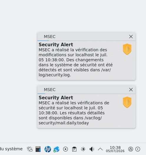

Bon, je déterre cette discussion qui date du mois d'avril de cette année (
)Je viens d'avoir cette alerte de msec.
Dans "/var/log/security.log" il y a ça :
juil. 04 14:08:00 localhost info: Total of user files that should not be writable: 1 juil. 04 14:08:00 localhost info: Total of open network ports: 0 juil. 04 14:08:00 localhost info: Total of configured firewall rules: 67 juil. 04 14:08:00 localhost info: Total local users: 33 juil. 04 14:08:00 localhost info: Total local group: 66 juil. 05 00:32:00 localhost info: Total of Suid Root files: 28 juil. 05 00:32:00 localhost info: Total of Sgid files: 12 juil. 05 00:32:00 localhost info: Total of World Writable files: 370 juil. 05 00:32:00 localhost info: Total of Un-owned files: 0 juil. 05 00:32:00 localhost info: Total of Un-owned group files: 0 juil. 05 00:32:00 localhost info: Total of SUID files with controlled MD5 checksum: 28 juil. 05 00:32:00 localhost info: Total of installed packages: 2731 juil. 05 00:32:00 localhost info: Chkrootkit check: skipped (chkrootkit not found) juil. 05 10:38:00 localhost info: Total of user files that should not be writable: 1 juil. 05 10:38:00 localhost info: Total of open network ports: 0 juil. 05 10:38:00 localhost info: Total of configured firewall rules: 67 juil. 05 10:38:00 localhost info: Total local users: 37 juil. 05 10:38:00 localhost info: Total local group: 70 juil. 05 10:38:00 localhost diff: *** Diff Check, juil. 05 10:38:00 *** juil. 05 10:38:00 localhost diff: juil. 05 10:38:00 localhost diff: Security Warning: change in local users found : juil. 05 10:38:00 localhost diff: - Added local users : avahi juil. 05 10:38:00 localhost diff: - Added local users : avahi-autoipd juil. 05 10:38:00 localhost diff: - Added local users : colord juil. 05 10:38:00 localhost diff: - Added local users : firebird juil. 05 10:38:00 localhost diff: juil. 05 10:38:00 localhost diff: Security Warning: change in local groups found : juil. 05 10:38:00 localhost diff: - Added local groups : avahi juil. 05 10:38:00 localhost diff: - Added local groups : avahi-autoipd juil. 05 10:38:00 localhost diff: - Added local groups : colord juil. 05 10:38:00 localhost diff: - Added local groups : firebird
Et dans "/var/log/security/mail.daily.today" il y a ça :
*** Security Check, juil. 05 10:38:00 ***
*** Check type: daily ***
*** Check executed from: /etc/cron.daily/msec ***
Report summary:
Test started: juil. 05 10:38:00
Test finished: juil. 05 10:38:02
Detailed report:
Security Warning: theses files should not be owned by someone else or writable :
- /home/gerard/.config : file is group writable.
Est-ce que ça vous dit quelque chose dans ce forum?
Puis-je laisser comme ça?
Édité par gerard-ll Le 05/07/2026 à 16h12
Yuusha :La première partie ce n'est rien. C'est juste msec qui est trop bavard. Par contre, ton .config ne devrait pas être inscriptible par le groupe. Il devrait être : drwx------
Merci Yuusha, c'est rectifié! :
drwx------ 20 gerard gerard 4096 juil. 5 17:22 .config/
Bizarrement sous Gnome ce .config est bien configuré drwx------?!
Edit : C'est bien msec en fin de compte! Ça surveille bien!
Édité par gerard-ll Le 05/07/2026 à 17h27
