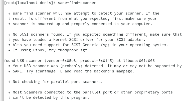

sane-find-scanner
mabthera Membre non connecté
- Inscrit le : 10/06/2019
Autre commande à lancer en root :
sane-find-scanner
sane-find-scanner
Voilà :
https://www.mageialinux-online.org/upload/capture_deecran_de_2020-09-26_12-04-47.png
[root@localhost denis]# sane-find-scanner
# sane-find-scanner will now attempt to detect your scanner. If the
# result is different from what you expected, first make sure your
# scanner is powered up and properly connected to your computer.
# No SCSI scanners found. If you expected something different, make sure that
# you have loaded a kernel SCSI driver for your SCSI adapter.
# Also you need support for SCSI Generic (sg) in your operating system.
# If using Linux, try "modprobe sg".
found USB scanner (vendor=0x05e3, product=0x0145) at libusb:001:006
# Your USB scanner was (probably) detected. It may or may not be supported by
# SANE. Try scanimage -L and read the backend's manpage.
# Not checking for parallel port scanners.
# Most Scanners connected to the parallel port or other proprietary ports
# can't be detected by this program.
