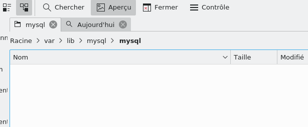

gustine :
Une question idiote : le service mysqld est bien lancé ?
[root@localhost a]# mysqld
2019-10-11 15:06:03 0 [Note] mysqld (mysqld 10.3.17-MariaDB) starting as process 22403 ...
2019-10-11 15:06:05 0 [Note] InnoDB: Using Linux native AIO
2019-10-11 15:06:05 0 [Note] InnoDB: The first innodb_system data file 'ibdata1' did not exist. A new tablespace will be created!
2019-10-11 15:06:05 0 [Note] InnoDB: Mutexes and rw_locks use GCC atomic builtins
2019-10-11 15:06:05 0 [Note] InnoDB: Uses event mutexes
2019-10-11 15:06:05 0 [Note] InnoDB: Compressed tables use zlib 1.2.11
2019-10-11 15:06:05 0 [Note] InnoDB: Number of pools: 1
2019-10-11 15:06:05 0 [Note] InnoDB: Using SSE2 crc32 instructions
2019-10-11 15:06:05 0 [Note] InnoDB: Initializing buffer pool, total size = 128M, instances = 1, chunk size = 128M
2019-10-11 15:06:05 0 [Note] InnoDB: Completed initialization of buffer pool
2019-10-11 15:06:05 0 [Note] InnoDB: If the mysqld execution user is authorized, page cleaner thread priority can be changed. See the man page of setpriority().
2019-10-11 15:06:05 0 [Note] InnoDB: Setting file './ibdata1' size to 12 MB. Physically writing the file full; Please wait ...
2019-10-11 15:06:05 0 [Note] InnoDB: File './ibdata1' size is now 12 MB.
2019-10-11 15:06:05 0 [Note] InnoDB: Setting log file ./ib_logfile101 size to 50331648 bytes
2019-10-11 15:06:05 0 [Note] InnoDB: Setting log file ./ib_logfile1 size to 50331648 bytes
2019-10-11 15:06:05 0 [Note] InnoDB: Renaming log file ./ib_logfile101 to ./ib_logfile0
2019-10-11 15:06:05 0 [Note] InnoDB: New log files created, LSN=45786
2019-10-11 15:06:05 0 [Note] InnoDB: Doublewrite buffer not found: creating new
2019-10-11 15:06:06 0 [Note] InnoDB: Doublewrite buffer created
2019-10-11 15:06:06 0 [Note] InnoDB: 128 out of 128 rollback segments are active.
2019-10-11 15:06:06 0 [Note] InnoDB: Creating foreign key constraint system tables.
2019-10-11 15:06:06 0 [Note] InnoDB: Creating tablespace and datafile system tables.
2019-10-11 15:06:06 0 [Note] InnoDB: Creating sys_virtual system tables.
2019-10-11 15:06:06 0 [Note] InnoDB: Creating shared tablespace for temporary tables
2019-10-11 15:06:06 0 [Note] InnoDB: Setting file './ibtmp1' size to 12 MB. Physically writing the file full; Please wait ...
2019-10-11 15:06:06 0 [Note] InnoDB: File './ibtmp1' size is now 12 MB.
2019-10-11 15:06:06 0 [Note] InnoDB: Waiting for purge to start
2019-10-11 15:06:06 0 [Note] InnoDB: 10.3.17 started; log sequence number 0; transaction id 7
191011 15:06:06 server_audit: MariaDB Audit Plugin version 1.4.8 STARTED.
191011 15:06:06 server_audit: Query cache is enabled with the TABLE events. Some table reads can be veiled.2019-10-11 15:06:06 0 [ERROR] Could not open mysql.plugin table. Some plugins may be not loaded
2019-10-11 15:06:06 0 [ERROR] Can't open and lock privilege tables: Table 'mysql.servers' doesn't exist
2019-10-11 15:06:06 0 [ERROR] Fatal error: Can't open and lock privilege tables: Table 'mysql.user' doesn't exist
[root@localhost a]# ^C
[root@localhost a]#
