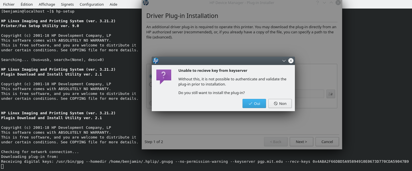

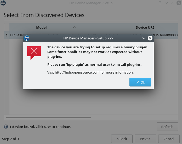

Il me propose alors de quand même poursuivre en forçant l'activation. Puis il m'affiche de nouveau un message d'erreur.
Il y a du mieux mais c'est pas encore ça...on est tout de même sur le bon chemin

Ensuite, je peux tester la nouvelle version de test. Ici n' ayant pas de HP, je ne peux pas tester depuis le début ( lancement de hp-setup il me semble).
Toutefois le lancement de hp-plugin me donne ceci:
[usertest@Mageia8 ~]$ hp-plugin -i HP Linux Imaging and Printing System (ver. 3.21.2) Plugin Download and Install Utility ver. 2.1 Copyright (c) 2001-18 HP Development Company, LP This software comes with ABSOLUTELY NO WARRANTY. This is free software, and you are welcome to distribute it under certain conditions. See COPYING file for more details. HP Linux Imaging and Printing System (ver. 3.21.2) Plugin Download and Install Utility ver. 2.1 Copyright (c) 2001-18 HP Development Company, LP This software comes with ABSOLUTELY NO WARRANTY. This is free software, and you are welcome to distribute it under certain conditions. See COPYING file for more details. (Note: Defaults for each question are maked with a '*'. Press <enter> to accept the default.) ----------------------------------------- | PLUG-IN INSTALLATION FOR HPLIP 3.21.2 | ----------------------------------------- Option Description ---------- -------------------------------------------------- d Download plug-in from HP (recommended) p Specify a path to the plug-in (advanced) q Quit hp-plugin (skip installation) Enter option (d=download*, p=specify path, q=quit) ? ------------------- | DOWNLOAD PLUGIN | ------------------- Checking for network connection... Downloading plug-in from: Downloading plug-in: [\ ] 0% Receiving digital keys: /usr/bin/gpg --homedir /home/usertest/.hplip/.gnupg --no-permission-warning --keyserver pgp.mit.edu --recv-keys 0x4ABA2F66DBD5A95894910E0673D770CDA59047B9 error: Unable to recieve key from keyserver Do you still want to install the plug-in? (y=yes, n=no*, q=quit) ?

En fait le message d' erreur vient du fait que le serveur pgp.mit.edu ne répond pas correctement ce qui empêche la validation de ce qui a été téléchargé.
En éditant le fichier /usr/share/hplip/base/validation.py en remplaçant pgp.mit.edu en ligne 45 par un autre serveur ( par exemple keyserver.ubuntu.com ( désolé, je n' ai pas trouvé de serveur de clés pour Mageia
[usertest@Mageia8 hplip]$ hp-plugin -i HP Linux Imaging and Printing System (ver. 3.21.2) Plugin Download and Install Utility ver. 2.1 Copyright (c) 2001-18 HP Development Company, LP This software comes with ABSOLUTELY NO WARRANTY. This is free software, and you are welcome to distribute it under certain conditions. See COPYING file for more details. HP Linux Imaging and Printing System (ver. 3.21.2) Plugin Download and Install Utility ver. 2.1 Copyright (c) 2001-18 HP Development Company, LP This software comes with ABSOLUTELY NO WARRANTY. This is free software, and you are welcome to distribute it under certain conditions. See COPYING file for more details. (Note: Defaults for each question are maked with a '*'. Press <enter> to accept the default.) ----------------------------------------- | PLUG-IN INSTALLATION FOR HPLIP 3.21.2 | ----------------------------------------- Option Description ---------- -------------------------------------------------- d Download plug-in from HP (recommended) p Specify a path to the plug-in (advanced) q Quit hp-plugin (skip installation) Enter option (d=download*, p=specify path, q=quit) ? ------------------- | DOWNLOAD PLUGIN | ------------------- Checking for network connection... Downloading plug-in from: Downloading plug-in: [\ ] 0% Receiving digital keys: /usr/bin/gpg --homedir /home/usertest/.hplip/.gnupg --no-permission-warning --keyserver keyserver.ubuntu.com --recv-keys 0x4ABA2F66DBD5A95894910E0673D770CDA59047B9 ---------------------- | INSTALLING PLUG-IN | ---------------------- Creating directory plugin_tmp Verifying archive integrity... All good. Uncompressing HPLIP 3.21.2 Plugin Self Extracting Archive.............................................................. HP Linux Imaging and Printing System (ver. 3.21.2) Plugin Installer ver. 3.0 Copyright (c) 2001-18 HP Development Company, LP This software comes with ABSOLUTELY NO WARRANTY. This is free software, and you are welcome to distribute it under certain conditions. See COPYING file for more details. Plug-in version: 3.21.2 Installed HPLIP version: 3.21.2 Number of files to install: 64 You must agree to the license terms before installing the plug-in: [...]
