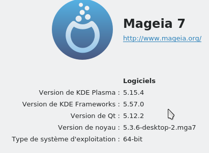

MA7 plasma.

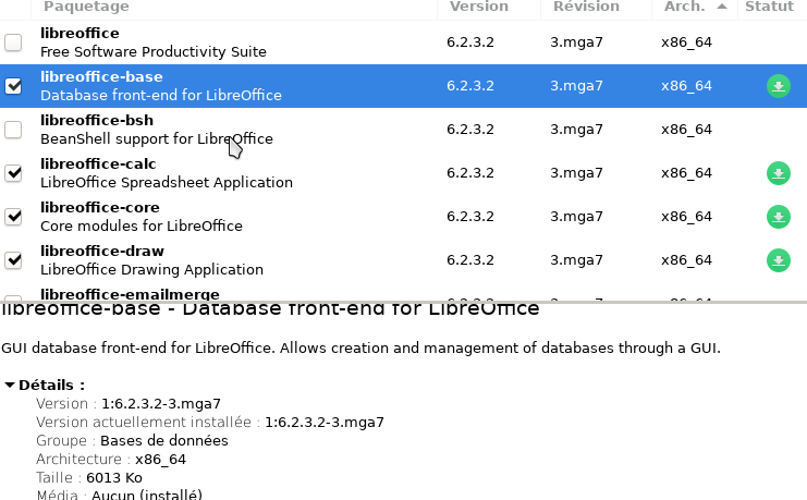

Est ce que tous les paquets sont installés ?
Que donne un rpm -qa | grep libreoffice ?

libreoffice-opensymbol-fonts-6.2.3.2-3.mga7
libreoffice-pdfimport-6.2.3.2-3.mga7
libreoffice-ure-common-6.2.3.2-3.mga7
libreoffice-langpack-fr-6.2.3.2-3.mga7
libreoffice-base-6.2.3.2-3.mga7
libreoffice-ure-6.2.3.2-3.mga7
libreoffice-calc-6.2.3.2-3.mga7
libreoffice-core-6.2.3.2-3.mga7
libreoffice-math-6.2.3.2-3.mga7
libreoffice-x11-6.2.3.2-3.mga7
libreoffice-6.2.3.2-3.mga7
libreoffice-writer-6.2.3.2-3.mga7
libreoffice-wiki-publisher-6.2.3.2-3.mga7
libreoffice-gtk3-6.2.3.2-3.mga7
libreoffice-graphicfilter-6.2.3.2-3.mga7
libreoffice-xsltfilter-6.2.3.2-3.mga7
libreoffice-pyuno-6.2.3.2-3.mga7
libreoffice-kf5-6.2.3.2-3.mga7
libreoffice-draw-6.2.3.2-3.mga7
libreoffice-data-6.2.3.2-3.mga7
libreoffice-help-fr-6.2.3.2-3.mga7
libreoffice-emailmerge-6.2.3.2-3.mga7
libreoffice-impress-6.2.3.2-3.mga7
