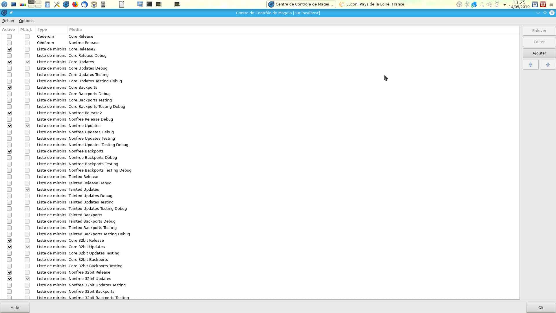

Voici mes dépôts :
[xxxx@localhost ~]$ urpmq --list-media active --list-url
Core Release2 ftp://distrib-coffee.ipsl.jussieu.fr/pub/linux/Mageia/distrib/6/x86_64/media/core/release
Core Updates ftp://distrib-coffee.ipsl.jussieu.fr/pub/linux/Mageia/distrib/6/x86_64/media/core/updates
Nonfree Release2 ftp://distrib-coffee.ipsl.jussieu.fr/pub/linux/Mageia/distrib/6/x86_64/media/nonfree/release
Nonfree Updates ftp://distrib-coffee.ipsl.jussieu.fr/pub/linux/Mageia/distrib/6/x86_64/media/nonfree/updates
Tainted Release ftp://distrib-coffee.ipsl.jussieu.fr/pub/linux/Mageia/distrib/6/x86_64/media/tainted/release
Tainted Updates ftp://distrib-coffee.ipsl.jussieu.fr/pub/linux/Mageia/distrib/6/x86_64/media/tainted/updates
Core 32bit Release ftp://distrib-coffee.ipsl.jussieu.fr/pub/linux/Mageia/distrib/6/i586/media/core/release
Core 32bit Updates ftp://distrib-coffee.ipsl.jussieu.fr/pub/linux/Mageia/distrib/6/i586/media/core/updates
Nonfree 32bit Release ftp://distrib-coffee.ipsl.jussieu.fr/pub/linux/Mageia/distrib/6/i586/media/nonfree/release
Nonfree 32bit Updates ftp://distrib-coffee.ipsl.jussieu.fr/pub/linux/Mageia/distrib/6/i586/media/nonfree/updates
Tainted 32bit Release ftp://distrib-coffee.ipsl.jussieu.fr/pub/linux/Mageia/distrib/6/i586/media/tainted/release
Tainted 32bit Updates ftp://distrib-coffee.ipsl.jussieu.fr/pub/linux/Mageia/distrib/6/i586/media/tainted/updates
Core Release3 http://ftp.free.fr/mirrors/mageia.org/distrib/6/x86_64/media/core/release
Core Updates2 http://ftp.free.fr/mirrors/mageia.org/distrib/6/x86_64/media/core/updates
Nonfree Release3 http://ftp.free.fr/mirrors/mageia.org/distrib/6/x86_64/media/nonfree/release
Nonfree Updates2 http://ftp.free.fr/mirrors/mageia.org/distrib/6/x86_64/media/nonfree/updates
Tainted Release2 http://ftp.free.fr/mirrors/mageia.org/distrib/6/x86_64/media/tainted/release
Tainted Updates2 http://ftp.free.fr/mirrors/mageia.org/distrib/6/x86_64/media/tainted/updates
Core 32bit Release2 http://ftp.free.fr/mirrors/mageia.org/distrib/6/i586/media/core/release
Core 32bit Updates2 http://ftp.free.fr/mirrors/mageia.org/distrib/6/i586/media/core/updates
Nonfree 32bit Release2 http://ftp.free.fr/mirrors/mageia.org/distrib/6/i586/media/nonfree/release
Nonfree 32bit Updates2 http://ftp.free.fr/mirrors/mageia.org/distrib/6/i586/media/nonfree/updates
Tainted 32bit Release2 http://ftp.free.fr/mirrors/mageia.org/distrib/6/i586/media/tainted/release
Tainted 32bit Updates2 http://ftp.free.fr/mirrors/mageia.org/distrib/6/i586/media/tainted/updates
Core Release (distrib1) http://ftp.free.fr/mirrors/mageia.org/distrib/6/x86_64/media/core/release
Core Updates (distrib3) http://ftp.free.fr/mirrors/mageia.org/distrib/6/x86_64/media/core/updates
Nonfree Release (distrib11) http://ftp.free.fr/mirrors/mageia.org/distrib/6/x86_64/media/nonfree/release
Nonfree Updates (distrib13) http://ftp.free.fr/mirrors/mageia.org/distrib/6/x86_64/media/nonfree/updates
Tainted Release (distrib21) http://ftp.free.fr/mirrors/mageia.org/distrib/6/x86_64/media/tainted/release
Tainted Updates (distrib23) http://ftp.free.fr/mirrors/mageia.org/distrib/6/x86_64/media/tainted/updates
Core 32bit Release (distrib31) http://ftp.free.fr/mirrors/mageia.org/distrib/6/i586/media/core/release
Core 32bit Updates (distrib32) http://ftp.free.fr/mirrors/mageia.org/distrib/6/i586/media/core/updates
Nonfree 32bit Release (distrib36) http://ftp.free.fr/mirrors/mageia.org/distrib/6/i586/media/nonfree/release
Nonfree 32bit Updates (distrib37) http://ftp.free.fr/mirrors/mageia.org/distrib/6/i586/media/nonfree/updates
Tainted 32bit Release (distrib41) http://ftp.free.fr/mirrors/mageia.org/distrib/6/i586/media/tainted/release
Tainted 32bit Updates (distrib42) http://ftp.free.fr/mirrors/mageia.org/distrib/6/i586/media/tainted/updates
Quelqu'un a-t-il essayé d'installer task astronomy ?
Tu as trois jeux de dépôts, en plus actifs en même temps.
Commence déjà par faire le ménage. Soit tu effaces tout et tu réinstalles un seul jeu, soit tu fais une sélection soigneuse pour n'en garder qu'un seul.

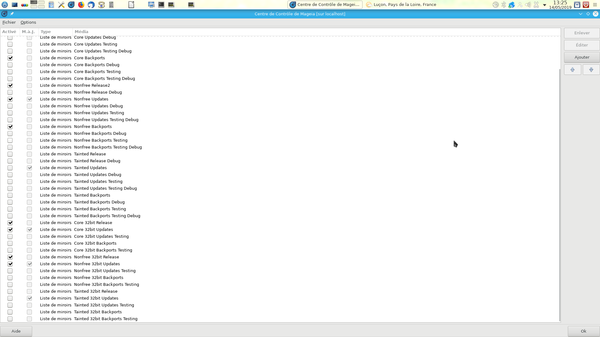

Bonjour clicere83,
Apparemment, le problème vient bien de chez toi : j'ai installé task-astronomy sur une Mageia 6.1 (à jour) dans une machine virtuelle et tout s'est déroulé sans problème (du moins au niveau de l'installation, car je n'ai testé aucun des logiciels installés).
clicere83 Membre non connecté
- Inscrit le : 29/04/2013
Voici ce que j'ai fais ce matin, j'ai passé la commande urpmq --list-media active --list-url , ensuite j'ai surprimé tous les dépôts; repassé la commande urpmq, liste des dépôts vide , puis mis à jour les dépôts sous CCM, puis de nouveau repassé la même commande, le résultat ci-dessous :
root@localhost xxxx]# urpmq --list-media active --list-url
Core Release2 http://magie.remi.lu/distrib/6/x86_64/media/core/release
Core Updates http://magie.remi.lu/distrib/6/x86_64/media/core/updates
Nonfree Release2 http://magie.remi.lu/distrib/6/x86_64/media/nonfree/release
Nonfree Updates http://magie.remi.lu/distrib/6/x86_64/media/nonfree/updates
Tainted Release http://magie.remi.lu/distrib/6/x86_64/media/tainted/release
Tainted Updates http://magie.remi.lu/distrib/6/x86_64/media/tainted/updates
Core 32bit Release http://magie.remi.lu/distrib/6/i586/media/core/release
Core 32bit Updates http://magie.remi.lu/distrib/6/i586/media/core/updates
Nonfree 32bit Release http://magie.remi.lu/distrib/6/i586/media/nonfree/release
Nonfree 32bit Updates http://magie.remi.lu/distrib/6/i586/media/nonfree/updates
Tainted 32bit Release http://magie.remi.lu/distrib/6/i586/media/tainted/release
Tainted 32bit Updates http://magie.remi.lu/distrib/6/i586/media/tainted/updates
[root@localhost xxxx]# urpmq --list-media active --list-url

Dans la log, il y a ce message (en gras dans la log ci-dessus) : L'installation a échoué : python-lxml < 3.8.0-2 est rendu obsolète par (déjà installé) python2-lxml-4.2.5-1.mga6.x86_64
Le problème vient de ce paquet qui est obsolète ?
Édité par clicere83 Le 20/06/2019 à 13h28
