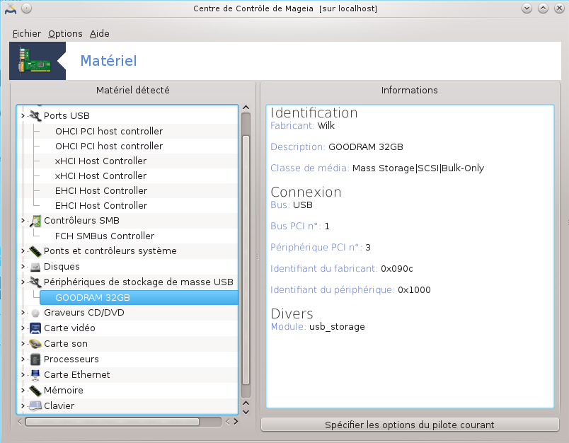

Voilà les retours suite à la demande de nmrk.n:

[25250.002548] usb 3-3: new high-speed USB device number 2 using ehci-pci
[25250.122779] usb 3-3: New USB device found, idVendor=090c, idProduct=1000
[25250.122787] usb 3-3: New USB device strings: Mfr=1, Product=2, SerialNumber=3
[25250.122791] usb 3-3: Product: GOODRAM 32GB
[25250.122794] usb 3-3: Manufacturer: Wilk
[25250.122797] usb 3-3: SerialNumber: 15112323008065
[25250.123852] usb-storage 3-3:1.0: USB Mass Storage device detected
[25250.123971] scsi host3: usb-storage 3-3:1.0
