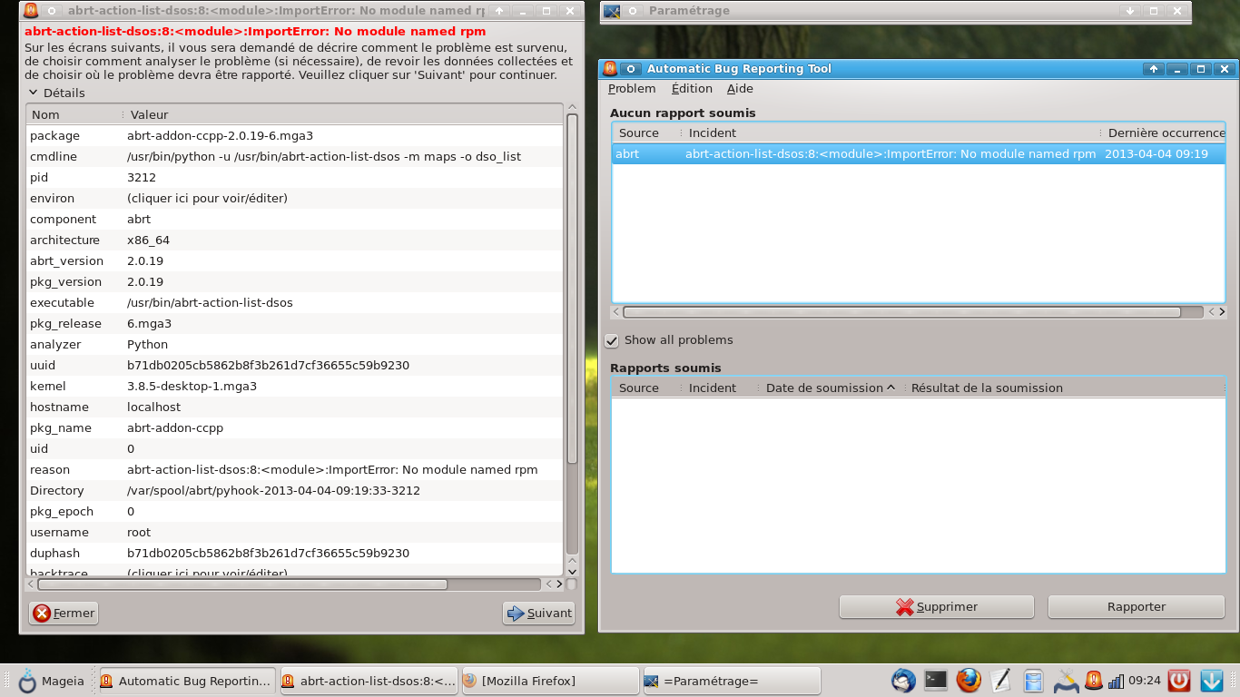

je sais pas toujours ce qui ne va pas avec mon système mais j'ai piste que je vais explorer:il semble que les données de crash sont supprimées du dossier /var/spool/abrt/.
# systemctl | grep abrt abrt-ccpp.service loaded active exited Install ABRT coredump hook abrt-oops.service loaded active running ABRT kernel log watcher abrt-vmcore.service loaded active exited Harvest vmcores for ABRT abrt-xorg.service loaded active running ABRT Xorg log watcher abrtd.service loaded active running ABRT Automated Bug Reporting Tool #journalctl -af Apr 04 13:55:24 localhost abrt[11558]: Saved core dump of pid 11548 to /home/????/core.11548 (327680 bytes) Apr 04 13:55:24 localhost abrtd[983]: Génération du backtrace Apr 04 13:55:24 localhost abrtd[983]: eu-unstrip: No modules recognized in core file Apr 04 13:55:24 localhost abrtd[983]: Running eu-unstrip failed Apr 04 13:55:24 localhost abrtd[983]: eu-unstrip: No modules recognized in core file Apr 04 13:55:24 localhost abrtd[983]: 'post-create' on '/var/spool/abrt/ccpp-2013-04-04-13:55:24-11537' exited with 1 Apr 04 13:55:24 localhost abrtd[983]: Corrupted or bad directory '/var/spool/abrt/ccpp-2013-04-04-13:55:24-11537', deleting
